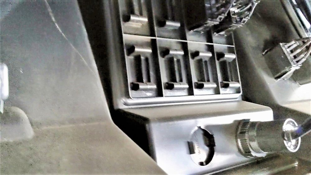

I've looked and tried to find any access to the in/out wiring for the Buck 450. I see no way to attached an aftermarket remote to the winch. The control leads are not exposed anywhere as far as I can find. Looks like they go from the sealed relay control box to the dash switch almost entirely sealed in the wiring harness. Anyone have any ideas how to do a winch remote connection on the Buck 450  without slicing into the main wiring harness? The winch switch is the leftmost in the photo.  Looks like the wiring is heat shrinked to the terminals and it's virtually impossible to get to the back of the switch anyway. This photo was taken from the passenger side wheel well  reaching as far as I could with my phone between everything that's in the way.
Looking for suggestions and if anyone has added a remote to the BUck 450, please share your knowledge.
