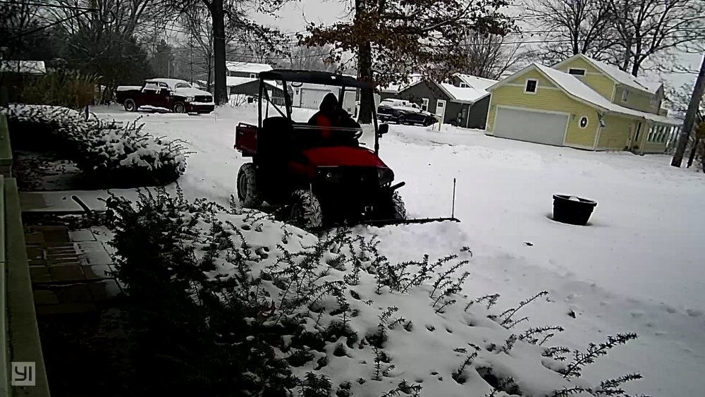

I also purchased this plow from Amazon, cost less than $500, got a 5% credit on account and free shipping. Got it in 4 days from Texas to Michigan. Had to cut corners of mounting plate to clear suspension arms. After cutting plate install was about an hour putting all pieces together and getting on the utv. Works GREAT!
Just had our 1st plowable snow for the season here in southern Michigan. After the highway department went thru for the first pass I took the Coleman UT400 with the 5' plow I had installed for its' first journey. We had approx. 4" with ice topping and after the plowing by the highway department is was approx. 8"-10" on the sides of the road. I  put the utv in 4x4, didn't really need it but the machine worked great for me. Don't know how it's going to work in wet deeper snow but for $500 what the hell. Good Luck!

Shaun B, I purchsaed the above snow plow system that you have listed. I installed it on Friday and got to use it on Sunday. I was plowing 4 inch snow with 10 inch drifts. went through it like butter in 4wd. could of eaily plowed a 10 inch snow. i also put two 70lb bags of sand in the box. it took about 7 hours for this old man to install. I am very pleased with that 6 foot wide plow and it is heavy duty..
I just plowed out of a 24 inch snow here in NE Ohio. I have a double wide 500 foot long driveway and my coleman ate the snow. I was able to clear it in about 20 minutes with snow mounds up to 10 feet. This little machine was a beast out there. Moreover it used my own homemade plow! I'm going to enclose it and add the aftermarket heater assembly. Then I can be nice and toasty plowing our neighbors driveways.

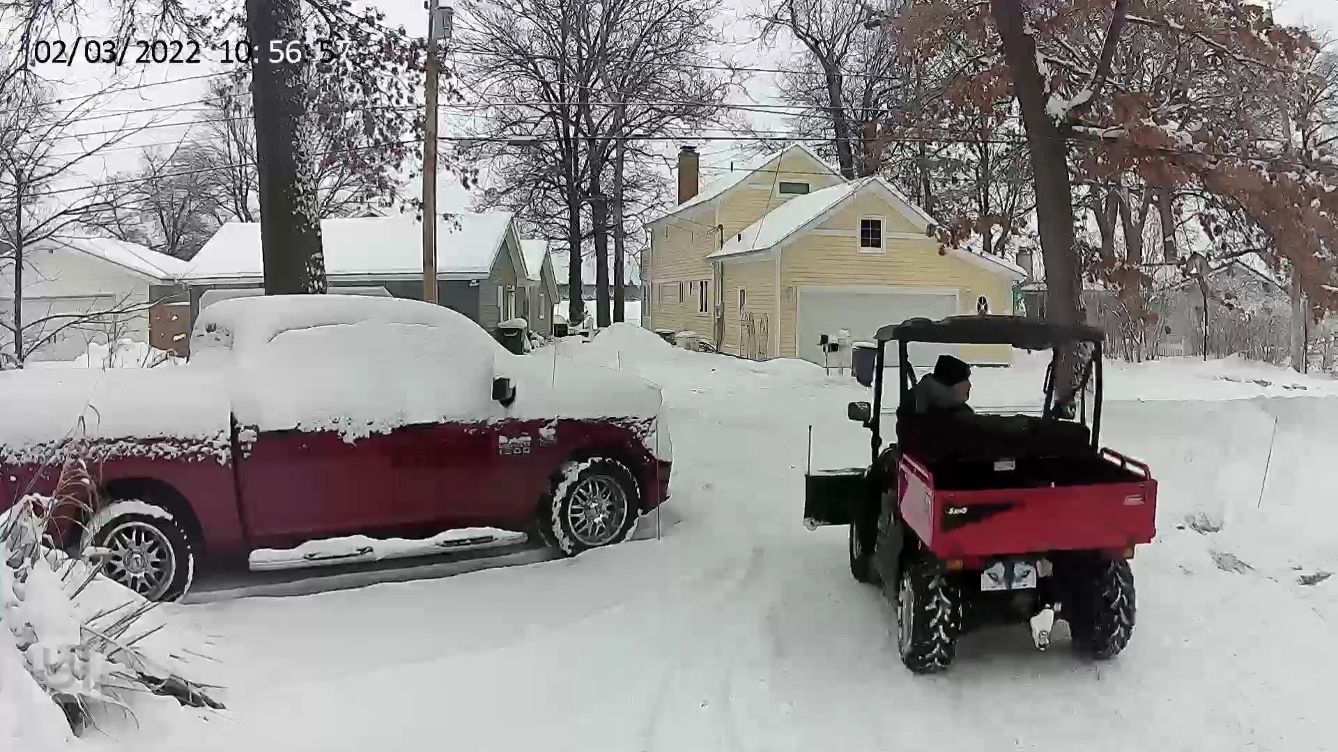

I beg to differ,   I plowed 18 inches of snow in Michigan last week wet & heavy snow.    I had NO problems,   1st time I've actually put it into 4 x 4

I just plowed 18 inches of wet heavy snow last week in Michigan, Had NO problem & it was the 1st time I've ever put it into 4X4
