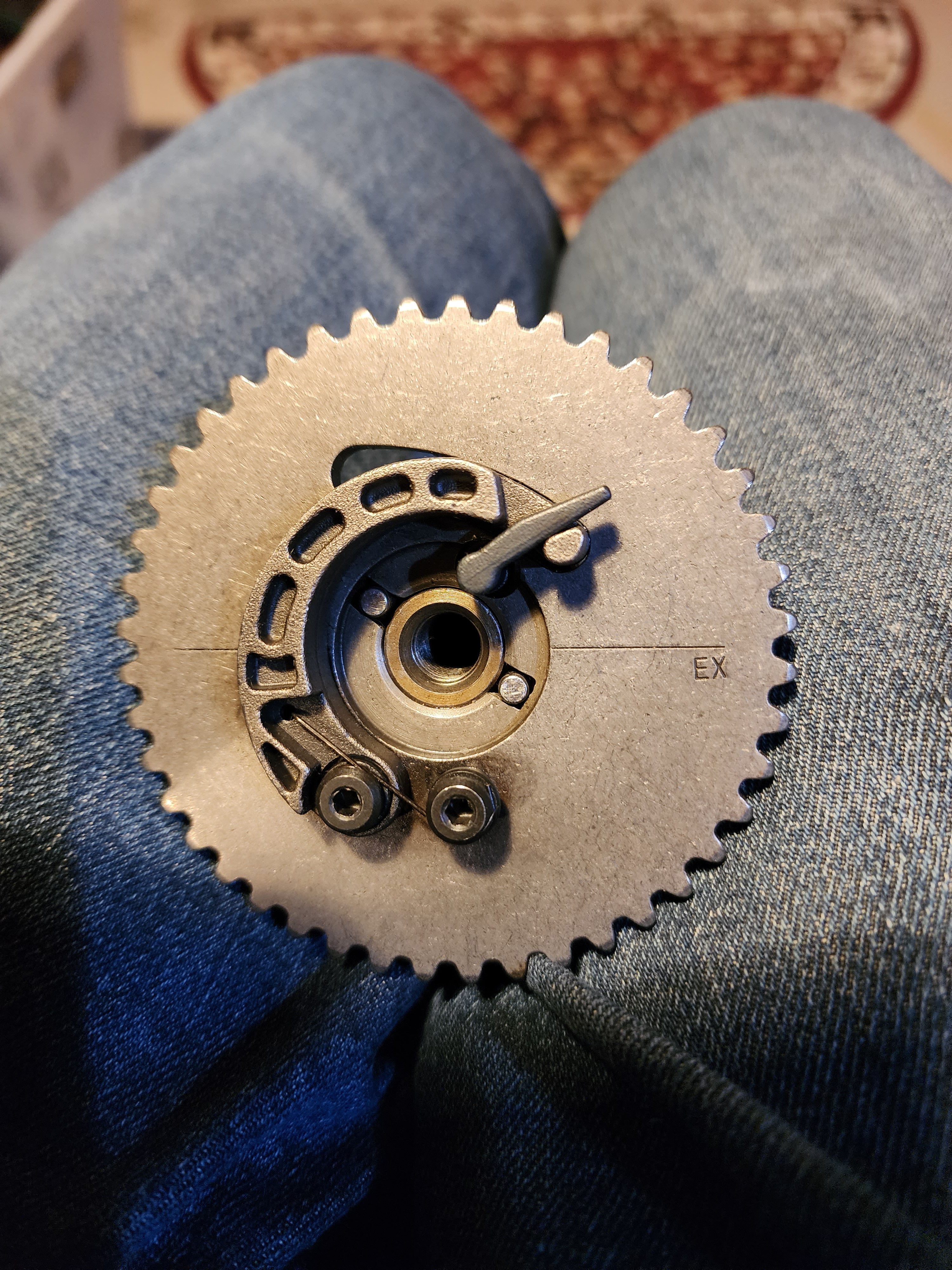

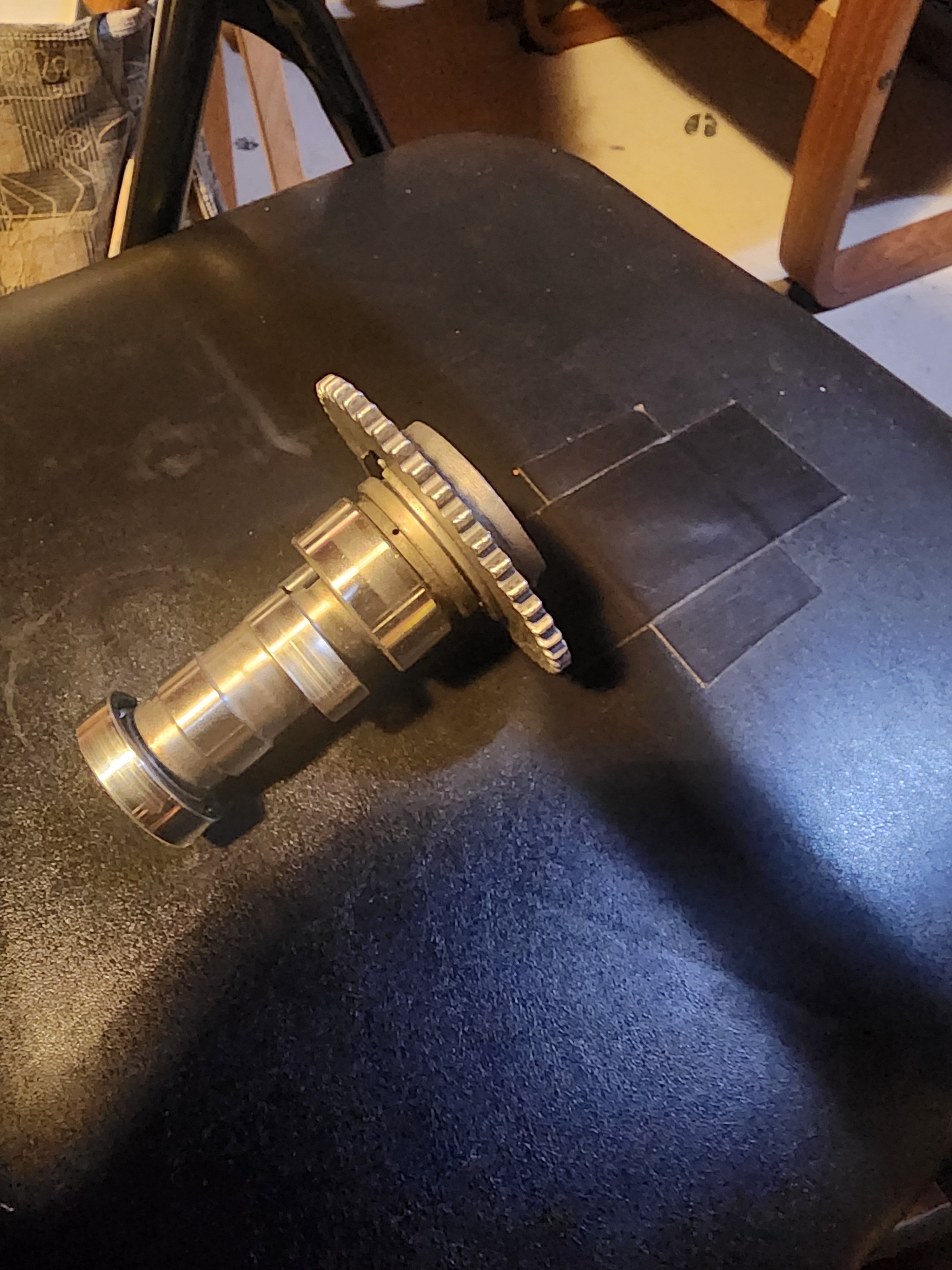

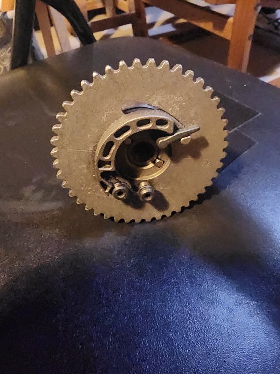

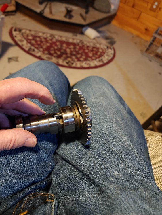

They could only get the whole assembly,  as I recall. They had to try several to get a good one.  They gave me one of the bad ones that I look at every day. My Tboss had been like a new machine ever since.  It is almost impossible to start the T Boss with a defective cam as it won't allow any compression release when you try to start it. And yes,  you will burn out starters AMF starter wires.  It's great when it works right but at one time I was as frustrated as you sound. Stick with it until you get a good cam that will allow compression release. In going to try to include two pictures of the cam assembly.
