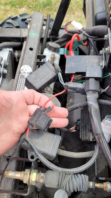

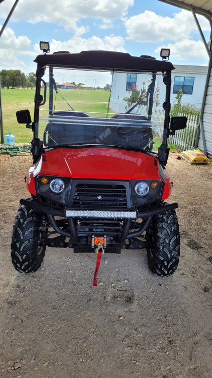

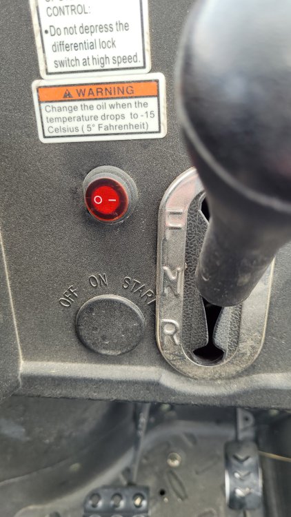

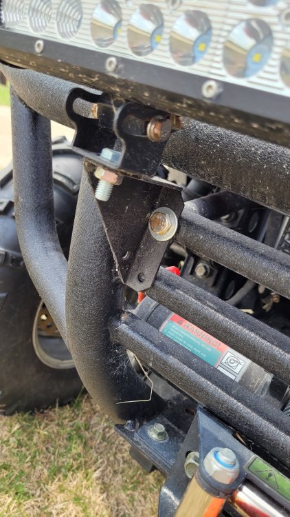

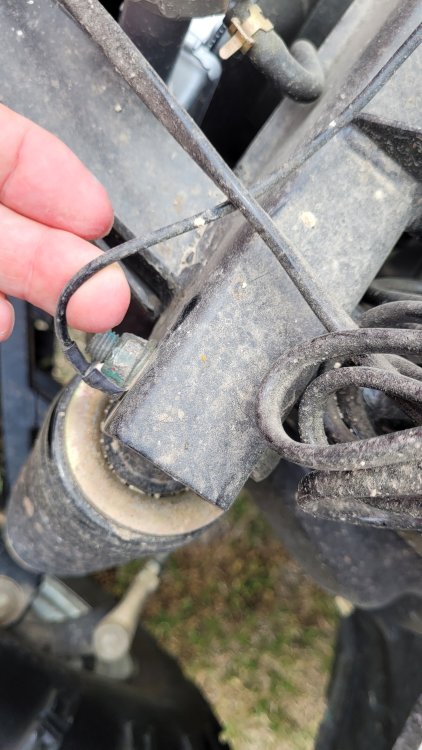

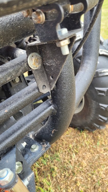

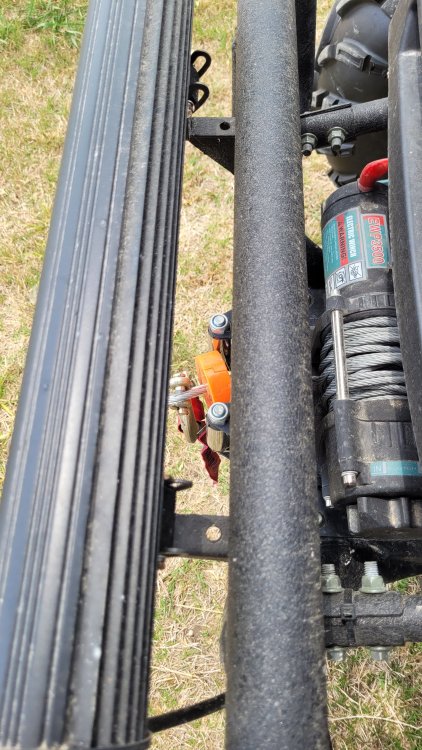

Mike, could you provide some more detail on your install?  I have the same machine and will be ordering the exact same lights from Amazon.  Did  you wire into existing fuse box or did you use a sub box etc.?  Any chance you have any close uo pics of the lightbar attached to the bumper?  Thanks in advance!
Jason
Jacksonville, Florida
Jason I have attached some pictures that should be self-explanatory. The power wire I connected directly to the battery cable under the hood since the lights come with its own fuse and the brackets I used I got from the hardware store and then painted them with rubber undercoating. I did have to drill two holes into the existing bumper. Hope this helps.
