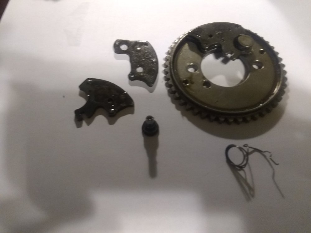

Okay guys, I found the problem on my Hisun 550.  One of the compression release cam plates on the cam chain drive gear came off and fell down into the gearbox and crankcase!  Luck was with me because none of it got caught into the crank or drive gears.  The little torsion spring  must have gotten pinched in one of the gears because it was mangled and cut in two pieces.  I was able to order a cam shaft assembly from Alpha-Sports and have installed it.  But I had to tear the magneto cover off to fish out all of the broken parts from the crankcase, and that took quite a bit of time.  The service manual is a little vague on setting the cam timing.  I found the timing marks on the chain sprocket and camshaft end, but the manual doesn't specify where those are located relative to the head.  After looking at other manuals, I believe that those marks should align with the top center of the head with the piston at top dead center.  If anyone knows different, please let me know.  THANKS
Yes!  On the inside of the head housing, behind the chain sprocket cover, there is a little projection at the very top that the timing marks on the cam sprocket and the compression release shaft should be aligned with when the piston is at top dead center.   The magneto flywheel has timing marks on it that lines up with the "peep window (behind the blower) when the piston is at top dead center.   I got the engine all back together and it runs great now!  :)
