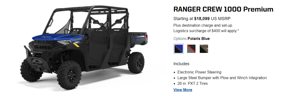

Its possible because Bobcat UTVs are made in a Polaris factory I beleive. Look at a Polaris Ranger Crew 1000. What accessory are you looking for?
See similarities:
Bobcat:
Polaris Ranger
I just bought the Kemimoto Center Rear View mirror model B0106-03401BK from Amazon for like $40 for my 2021 UV34 and it fastened right on no problem. It’s meant for the Polaris Rangers. I also just ordered Seizmik 18081 side rear view mirrors and will be taking the bracket off to bolt right onto my Bobcat full doors bc it has the same bolt location as the Polaris Ranger hard doors and many Polaris owns have had great success doing so. I am also very curious of other Polaris accessories and how they fit the newer 2021 Bobcat UV’s like bumpers and accessory lights.
