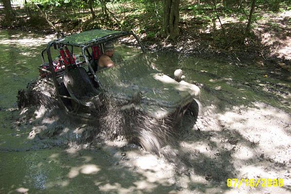

i havnt had any problems but i was in a mud hole and was playing in it and i filled it up full of mud and had to pull it and clean it up but i put a new one in it and just put the old one up it was in good shape though. that dang driveling goes right through the bellhousing and when your in mud it sucks it right up and filles it up with it.

I just got back from a weekend trip and had a bit of clutch issues. Firstly, I got into a really tight spot and smoked it a little bit but not bad I just think that if we had a stronger clutch unit I wouldn't have had a problem. this will really be a concern with more torque. secondly I was riding in a bunch of clay mud type holes and after a while i noticed that i couldn't got the trooper into gear because it wouldn't stop turning so i had to shut the unit off to change between forward and reverse. so this cut my day short and I had to return to camp to consume some beers. but on my way i stopped in the river to wash off and as usual i drive in so the water is almost over the rockers and leave the trooper running. after cleaning up I left the river and carried on but all of a sudden my clutch worked like new. It is obvious now that in all the mud I packed the pads full of mud and the river cleaned it up. I sure wish I knew this before I headed back to camp.
My idea for a solution would be to seal off the bellhousing and put 2 snorkels on it to circulate air to keep the clutch cool and dry.
sorry about the long story I will try to get pictures of my predicaments.

any ideas how to seal the bell housing cause the driveline goes right thru it? i tryed to wash mine out i couldnt get it clean enough had to pull the eng man was that a pain.
