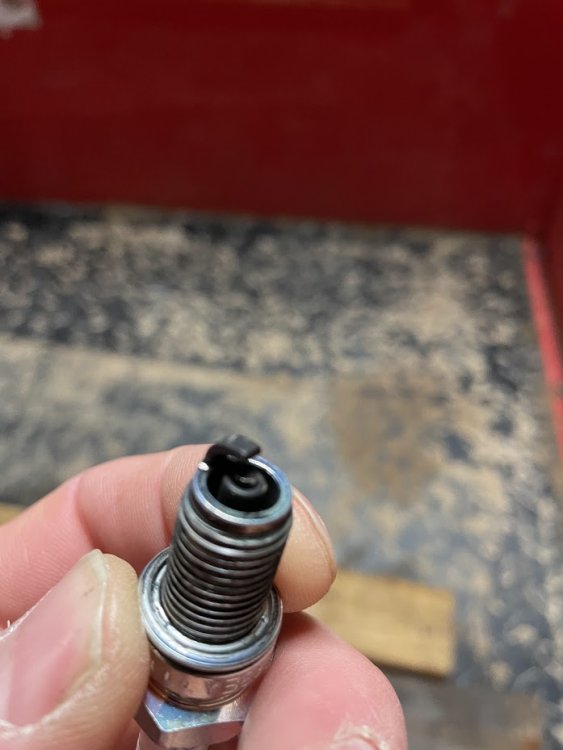

I changed the plug again and it stopped starting up.  I checked the plug and it has a ton of carbon on the end.  I maybe ran this machine for an hour and the plug looks like this.  Am I correct thinking that the fuel mixture is to rich?

I can't see a pic of your plug, care to upload one? If you have excessive carbon build up it may be too low a heat range, or you may have something else going on. What model plug did you uave installed?
I put in what the manual indicated, DR8EA (NGK) so apparently I should be using a different one.  This will be the 4th one I have put on.  What one should I be using?  I'll post a photo of the plug tomorrow.

If the air filter was installed backwards that may make the machine hard to start and use more fuel or give a rich fuel/air mix and cause carbon build-up on plug. Doesn't hurt to check. Maybe need to clean air filter.
To keep from replacing spark plugs. Soak in regular gas overnight and a good stiff brush to clean off the carbon for the next use.
Carbon buildup can come from rich gas/air mixture like you said. But can also be a leaking fuel injector, weak coil spark, or bad spark plug wire.
