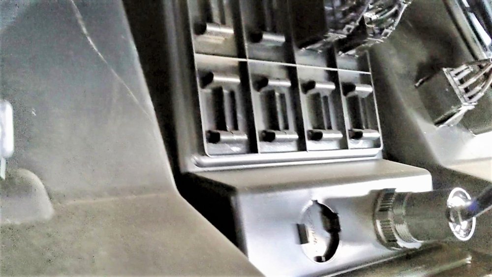

Talked to Massimo Tech Support. They say you have to access the switch panel from backside by going under the vehicle. Doesn't sound easy or fun.  I'm going to keep looking. It's too cold outside to do much. I want to see what's behind the battery if I remove it.  And also if the top panel of the dash when the storage bins is removable by taking out the the kex cap screws.  Here's a photo of the switch panel and USB charge port I took from the passenger side wheel well.  Not a lot of room to work from that angle. Might be more accessible from underneath the vehicle. I can't really tell without a lift.

I got this from another Massimo owner.  Looks like there is no easy way.
T-Boss 750, same problem. Pop the switch pop-outs out, tape your wiring to something stiff like a coat hanger wire and extend the wire thru the hole from the back. Connect to the switch then pop the switch into the hole from the front. If you have a common +12 or ground to each switch, prewire a mini "harness" to go between the switch holes. You may have to reach the harness leads with a hooked wire from the front and pull it through. If you can see it with your camera you can get a wire to it. I was able to get to mine from in holes in front of the firewall area.
