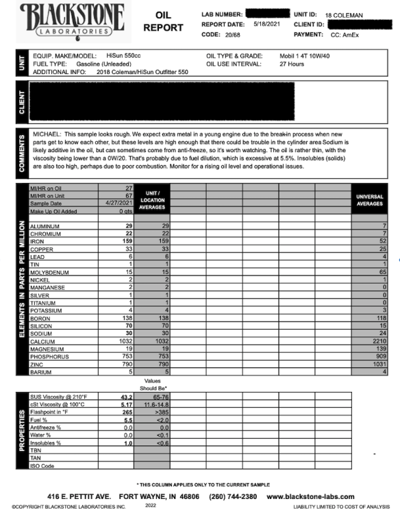

I used Mobil 1 4T 10w-40 when I had a Coleman / Hisun and run Mobil 1 products in all of my vehicles.  Which as others have stated, is a wet clutch so you need a motor oil that designed for that.  Had no issues with the oil itself.  The machine, which would make that oil resemble gritty mud after 20 hours, I had an issue with.

Gritty mud?  hmm.....have you checked for a head gasket leak?   Sounds like coolant in the oil.  mine has never looked like that in my HISUN  500 engine.. Not even the break-in oil it came with.. I changed that at 15 miles after Head Gasket leak, and then cracked head issues.  then once more at 100 miles after waterpump fail.  .  and now I change it every 400 miles.. It looks fine at 400mi but I change it anyway.   Amazon oil filters and Castrol Actevo M/C 10W40

I traded it in on a Kubota.  The decision was fairly easy because:
1. I sent the oil off to the lab.  The report that came back was about as good as our current political environment.
2. All of my other equipment is diesel.  I have diesel tanks for my equipment. The RTV-X1140 is diesel and has some other nice features (4 seater mode or 2 seater mode allowing for more people or more cargo).
3.  Kubota was offering 0% financing for 48 months.
4.  All of the rest of my equipment is Kubota and I have never had a single issue with any of it.
You might be right about the head gasket.  I did not check.  It was under warranty and all of warranty repair places around me stopped working on them. Kinda strange that 3 different places stopped at or about the same time.  I took that as a sign of future grief and traded it in a Kubota.  Had nothing but good times since.

In case you're interested, here is the oil report.
