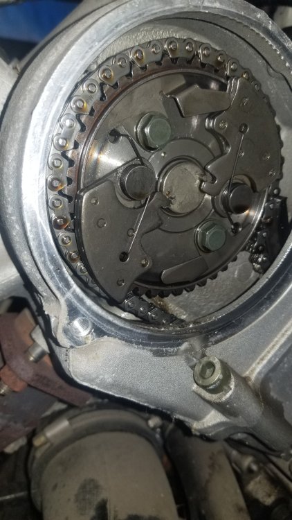

Ok guys, opened up cam window and removed timing chain cover. Looks like the chain is free spinning behind the flywheel as when I give harmonic balancer one revolution chain rains in place and is overly loose. Have to buy a 3 prong pulley to remove sprocket as flywheel and magneto has been removed.  Wondering if chain sprocket behind water pump drive sprocket broke? Any thoughts or suggestions?
