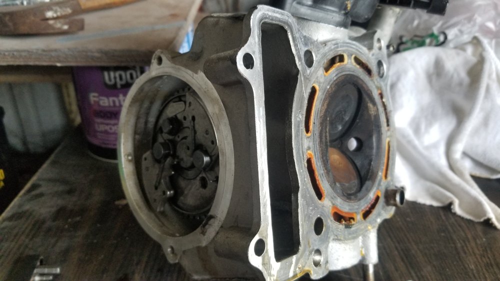

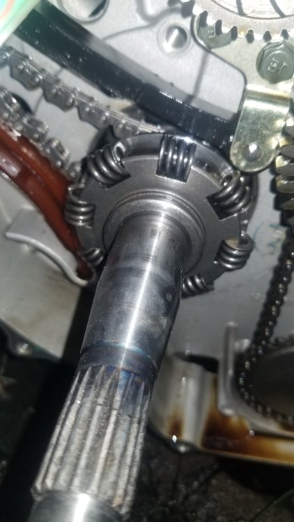

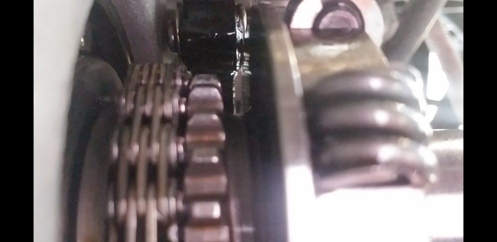

1 hour ago, Dumbfounded said:
Also as cam picture shows, the left cam lock appears not to be in phase with the right one.
Looks a bit bent too. Is that peening on the hook on the left in that first picture ?

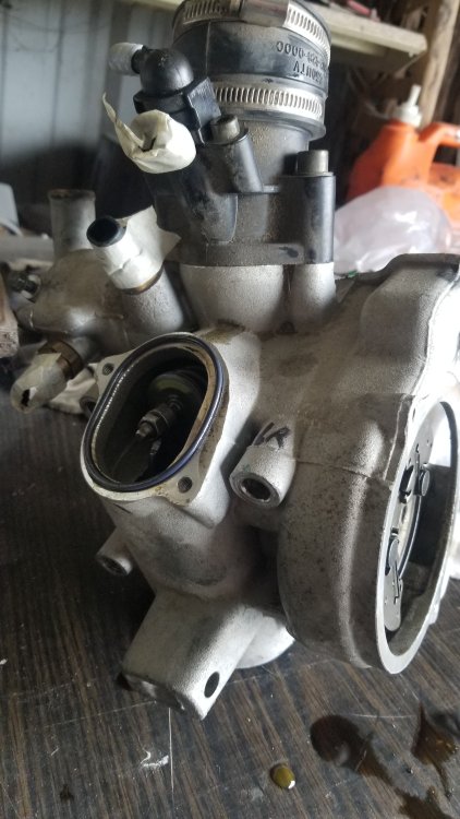

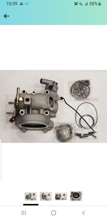

Ok, sad news is I removed head and it turn out it is one complete sealed unit. Found one on line for $400. Tried turning the cam to see if valves open and close but to no avail. 1/4 turn on cam phaser in each direction but not any further.
That's a lot of stuff under that cover. Seems likely that at least a couple, and probably most of those parts would have to nest together, with one inside the other. Maybe you missed one, requiring it to be indexed, and it's not fully seated?
