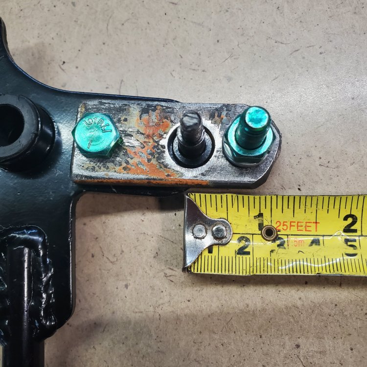

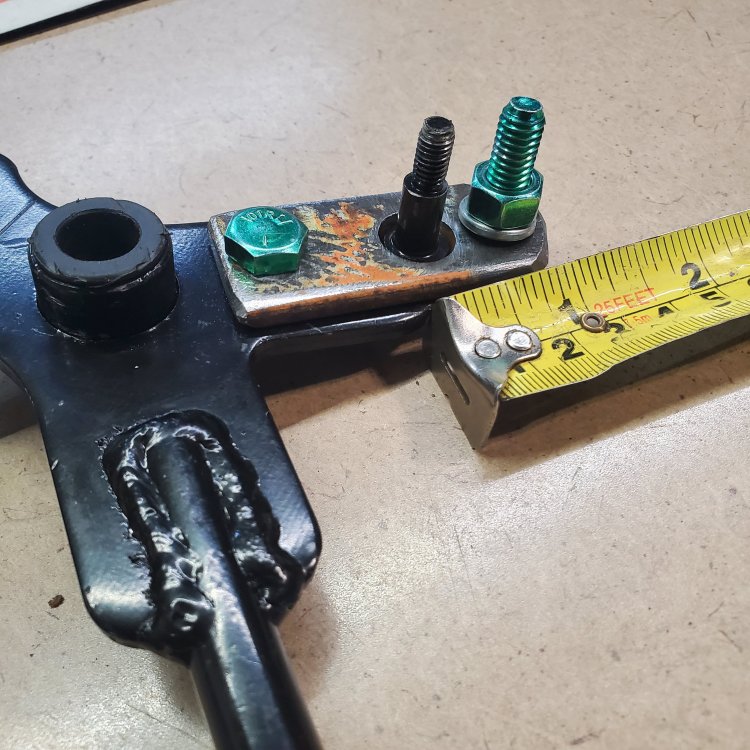

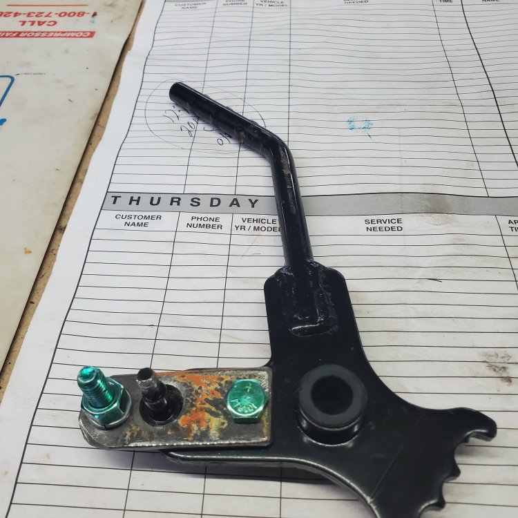

If you can take the lever out of the UTV, just take it to anyone that welds and have 3/4" added to the cable end of the lever.  I did that and I can attest to the "fix", I plowed snow for 2 hours Sunday and had zero shift issues.  The past snow storm I had kick outs all the time and had to be very sure of the shift to keep it in gear.  This "for me" fixed my issues just by adding 3/4" in length to the lever arm.
Here's the link in the forum to my modifications.
SHIFT LEVER MODIFICATIONS

Just a thought on the replacement shift lever, this is not just a replacement original part.  They will have to make all new dies to stamp out the new longer shift lever.  I could take months for them to get this done, IF they feel it's necessary at their end.  We're all at their mercy!
Someone else here has done this and just used a piece of steel and a couple bolts to extend the shift cable pin about 3/4".  Welding is more permanent and stronger in my opinion, but a good couple 1/4-20 bolts and some steel would do just fine.
Remember, when taking off the shift lever, work the outside shaft/lever bushing out of the pivot tube and then slide a very thin blade into the back side of the lever pivot tube and work the inside plastic bushing out.  This will give you more than enough wiggle room to remove the lever without having to take the bezel off of the dash.  Also, when you've done the 3/4" extension, you "should" take the cable out of the frame bracket and with a 12" or 15" Cresent wrench, tweak the cable mount a bit to allow the cable to be aligned with the new position of the shift lever pin.  I had to remove one of the crip clamps on the rubber shift cable boot and when finished, just used a small cable tie to secure the boot again to the cable housing.
This is NOT a bad task to do.  My UT400 now shifts with authority and has not jumped out of gear.  I plowed for around three hours in the last snowfall and zero issues.

When you do the 3/4" extension, you will have to "bend" the cable mounting bracket just a bit to regain the correct alignment of the cable with the newly extended shift lever.
Rather than doing the plate and drilling etc,, I would opt for taking the lever to a fab shop and ask that they add 3/4" into the lever as I did.  This should not cost much and will be better than bolting it together.  But bolting it all up "may" be a permanent solution.

I found out quickly that the bushing was a 2-piece plastic bushing.  With the inside bushing out of the shifter, you can rotate the lever to the side and it will all come out without having to remove the bezel.  Once all apart and cleaned up, all the pieces were loose and lubricated for reassembly.
Like I said, you should bend down the cable bracket mount just a bit to re-align the cable end with the lever.  I used a large Cresent wrench to bend the bracket without any problem.
