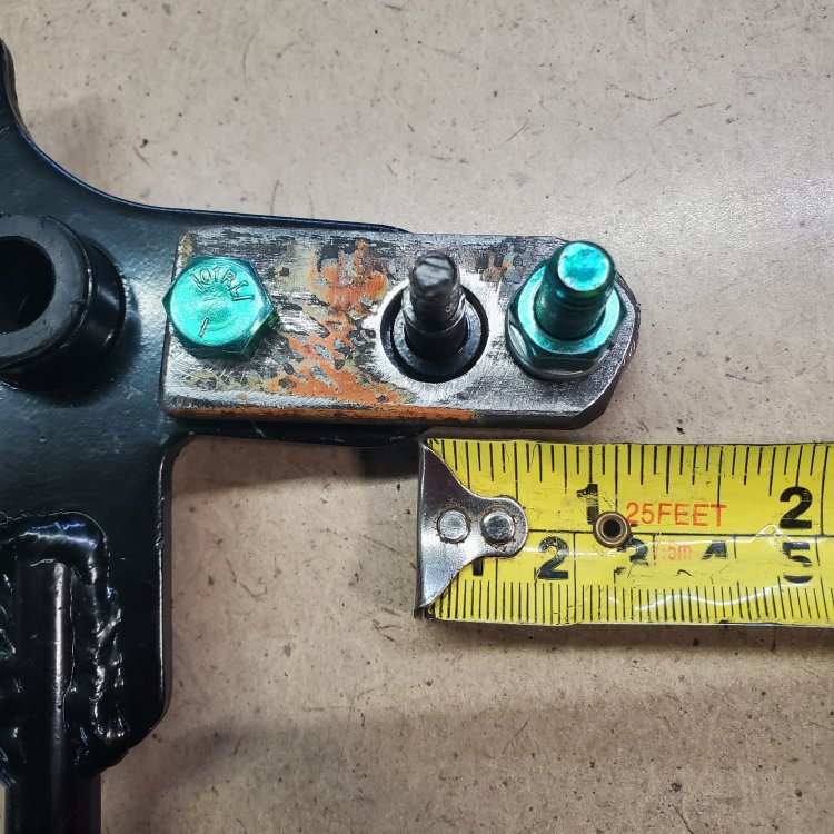

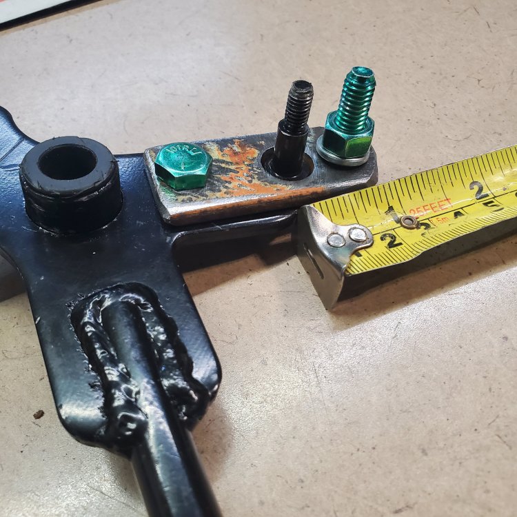

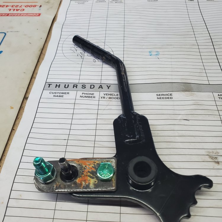

I have done both, the bolted extension and welding , Just had a new claim for shift issues come in , new machine and it had the updated shifter from factory . Somebody listened , lol . I had to extend this shift lever another 1/2 inch .  Inch and quarter from original. Few cable adjustments and works fine now .   Also see lot of brake squealing noise complaints . Jack up wheel , grab top and bottom, wiggle. If it moves wheel bearing is loose and  will let rotor just touch brake pad and make noise . Pull Cotter pin, tighten axle nut to next  pin position . Usually fixes it .  Coleman rep said they were moving warehouse or some BS . Parts wont be shipped for few weeks yet as of 7/23 /23 . I got tired of waiting and just mod the shifters myself and bill coleman for it now .  Cant have stuff sitting for months.

Great info - thanks. So just to clarify, the new models coming in with the updated shifter still had to be extended? If so, that would be the inch and a quarter you mentioned, but is there enough room under there? Seems on my 2021, adding 3/4" is going to get the mod fairly close to the top of the firewall.
I am having my son-in-law do the mod for me tonight or tomorrow by cutting the shifter and adding an additional piece in the lever. Since it's a 2021, should I tell him to do the 3/4", as others have done or go to the inch and a quarter? Maybe the newer models are different than the 2021 and needed the extra 1/2". Advise please and thank you.

Does anyone know what the distant should be after the mod, center-to-center, from the sleeve to the rod where the cable seats? I didn't take a before measurement to make sure the final fix was 3/4" longer.
What happened was, the individual who did the work for me as a favor, followed a photo I gave him of what Dan did, which I thought would be the best route to go. But after cutting the shifter and dropping in a 3/4" plate, he welded it with the rod going the wrong direction, facing the passenger side instead of the driver's side.. He had to cut and weld it again, but with the 2 cuts, I think that took away from the overall length needed. Mine measures out, center-to-center 2.75", but I think from looking at photos, it should be 3", so the extension might only be a 1/2".
I'm putting it back together tomorrow for a test run and he said he would add another piece to extend the shifter if needed, so we will see. Hopefully it will be okay, since I really need to get this up and running. But I was just curious if anyone had done a measurement after the mod was completed.
UPDATE - Shifter Lever: Well, I got everything back together and it was a humdinger getting those plastic bushings to fit back into the shifter sleeves, even though they were cleaned up and greased. Got the cable adjusted, as per Coleman's recommendations, but the cable adjustment maxed out, which got me concerned. Did the first test run and it was worse than ever. Backed off on the cable adjustment in the only direction it was able to go and SUCCESS. So far, and we will see, no more grinding or slipping out. Now I have to use it around the property and give it a real test.
Note: I would think that with the extended shifter piece I would have had to adjust the cable more towards the firewall, but instead, I had to adjust it and pull the cable more towards the front of the UTV, which maxed out the threads. But after adjusting it back slightly towards the firewall, it works, for now. We shall see.

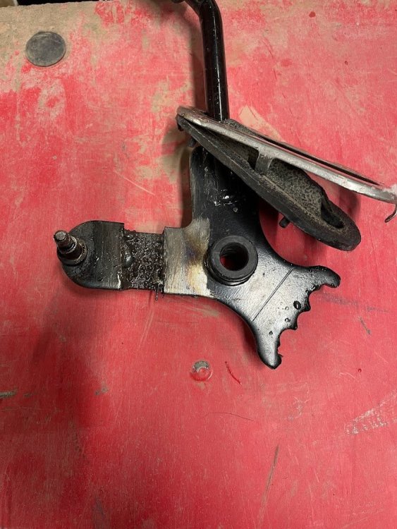

Tonight, I finally got to doing this and it fixed my issue with the machine popping out of gear.  I did it slightly differently, by cutting the existing and welding a piece on to it, to make up the 3/4".  I'm not a welder so the welds are not pretty.
Looks just fine and as long as it works, it's a win-win situation. No one is going to see the welds under the hood anyway. Just make sure you do some readjusting of the cable to compensate for the distance change and you should be fine. Took me about 3 tries before I got the cable readjusted and probably can use another adjustment, but all-in-all, the UTV does run better.
If you take the two nylon bushings out of the lever, you DO NOT need to remove the rubber seal and bezel.  The lever just slides off the shaft quite easily.
I was one of the first to do this modification.  AND FOR ME, it's been the FIX!  I plowed two days ago for over two hours and never once did it jump out of either forward or reverse.  If the cable system has been really abused, and the unit has been jumping out a LOT, this may not fix the issue.  It's very possible that you might have internal issues that only new parts can fix.  But be rest assured, that if you do not do the 3/4" extension on the lever AND replace new parts internally, you will be right back jumping out of gear all over again.
Most anyone can take the lever off and take it somewhere to be extended.  Even realigning the cable bracket after the lever has been extended, is quite easy to do.
I adjusted the cable, it took me a few tries also.  But seams to be working good now, hope it last.
After I did the modification it seemed that the recommended adjustment procedure didn't work properly. So I winged a readjustment and it worked good for a short period of time then after a while I was having slight grinding again, but not as bad.
Adjusted it again and all was well, but then recently it seemed seemed to have a loud bang, as if it had totally slipped out of gear, but it was still in, which was strange. I was concerned there were some internal issues, but noticed that the shifter was hitting up against the upper part of the bezel and possibly not going all the way into forward gear.
I adjusted it one more turn and it is now doing good so far, plus I seem to have a hair more space between the top of the bezel and the shifter rod, so we will see. It may need another adjustment along the way, but all-in-all, the modification does seem to be helping and does make me feel a little more confident.
