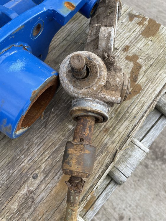

Well, getting the rack off was relatively painless. Of course, it helps that I've got a lift in my workshop. New one slotted in fine - a bit of jiggery-pokery needed to make sure it was centred, since it didn't come out of the bag that way. I'm still waiting on a few parts for the front suspension, so no point connecting everything up just yet. Sorting out the tracking is going to be fun once I do.
Taking the old rack apart, it appears the problem was failed seals letting in water. About a pint of brown oily sludge made a horrible mess of the floor when I took the big rubber bellows off, and the internal ball joints were both shot. The spigot where the rack connects to the steering rod is way off centre - pushed forward, as it were - which is no doubt where the water was getting in. I presume there's a worm gear in there, although I've not taken anything else apart yet. Pushed off centre like that means the gear teeth don't interlock properly, explaining why the steering wheel would spin freely in one direction without anything happening.

added photograph
