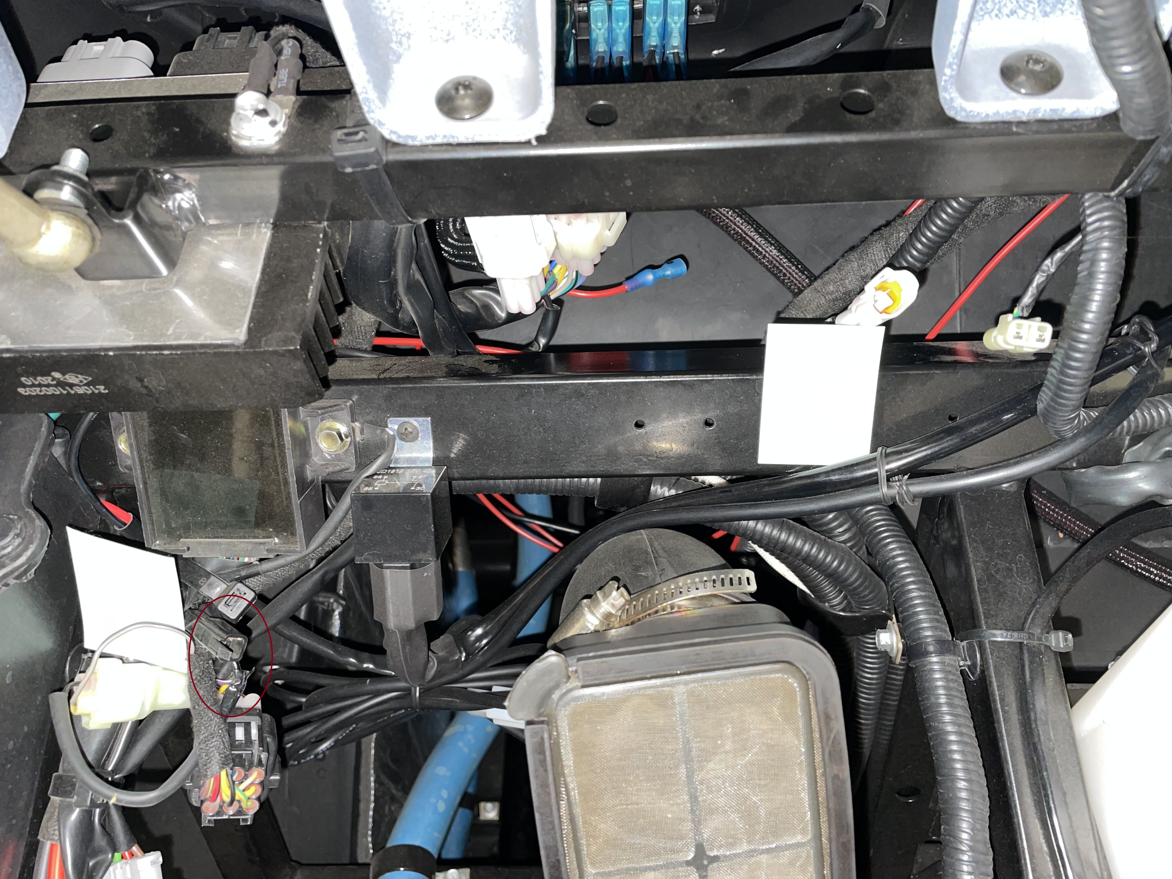

Ware is the lsv located at
IMG_0307B.thumb.jpg.c4d5e7aaef6f249529eb581f6a2f1e95.jpgIMG_0307B.thumb.jpg.c4d5e7aaef6f249529eb581f6a2f1e95.jpg
Here is a picture. Red circle on the left. Zoom in. Black connector, single wire. Hope moderator posts this one. He didn't post the last one?!?!? Can't figure out why??
Good Luck Steve!
