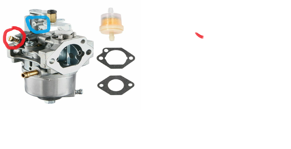

Just to be sure,  The jet I  circled in red is the pilot jet, which you adjust until the engine reaches the highest idle,  now this idle may be too high too high for it to go into gear properly  so you adjust it to the 1300 rpm spec with the screw in blue
