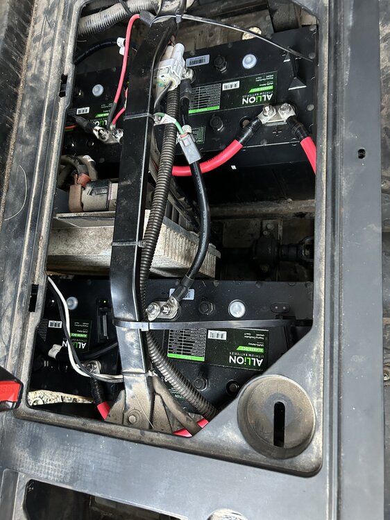

Well i took the dive and got x4 Allion GC2's.
Very easy installation - virtually a battery swap as they are the same size. Only thing i had to do was make a couple of new cables, but that was easy enough.
As someone else earlier in the thread said - night and day from the Discover batteries. So much weight removed the E1 site higher and the steering is now very easy.
Max power is now available and it shoots up steep hills - something the Discover batteries never really did. Combo of weight removal and more power i think. All thats left is to update the Delta charger to a lithium profile, but so far, worth the $5k (Aus Dollars).
If you are thinking of doing it, don't hesitate!

Ok, so after the new LifePo4's are in, the one wild card i though might crop up, has.
Before was dumb batteries with a smart buggy system. Now its smart batteries 'talking' to a smart buggy. If i have the new batts at 100%, when we leave our property we have a very steep hill for 100m's. The regen is trying to feed the full batts, but the batteries BMS is obviously just rejecting the charge as full, and throwing something at the buggy system, which the means the buggy throws up an error message  (5### - forgot to make a note of it).
All power is lost, but easy to reset by simply turning ignition off/on again at bottom of hill. So questions are:
  • Has anyone experienced this?
  • If so - what have you done to fix it (we are simply charging to 95% instead of 100%)
  • Anyone know how to disable the regen? We don't need it anyway.
    Cheers.

Can’t speak for others but the Allion batts were straight swap, everything worked. Had to make a couple of longer leads, and since changed DeltaQ to Lithium profile, but essentially a drop-in system. About three hours all up.
Amazing performance now and getting 400a draw on dash meter when up very steep hill with four people in, so finally using the systems full potential. Very happy.
