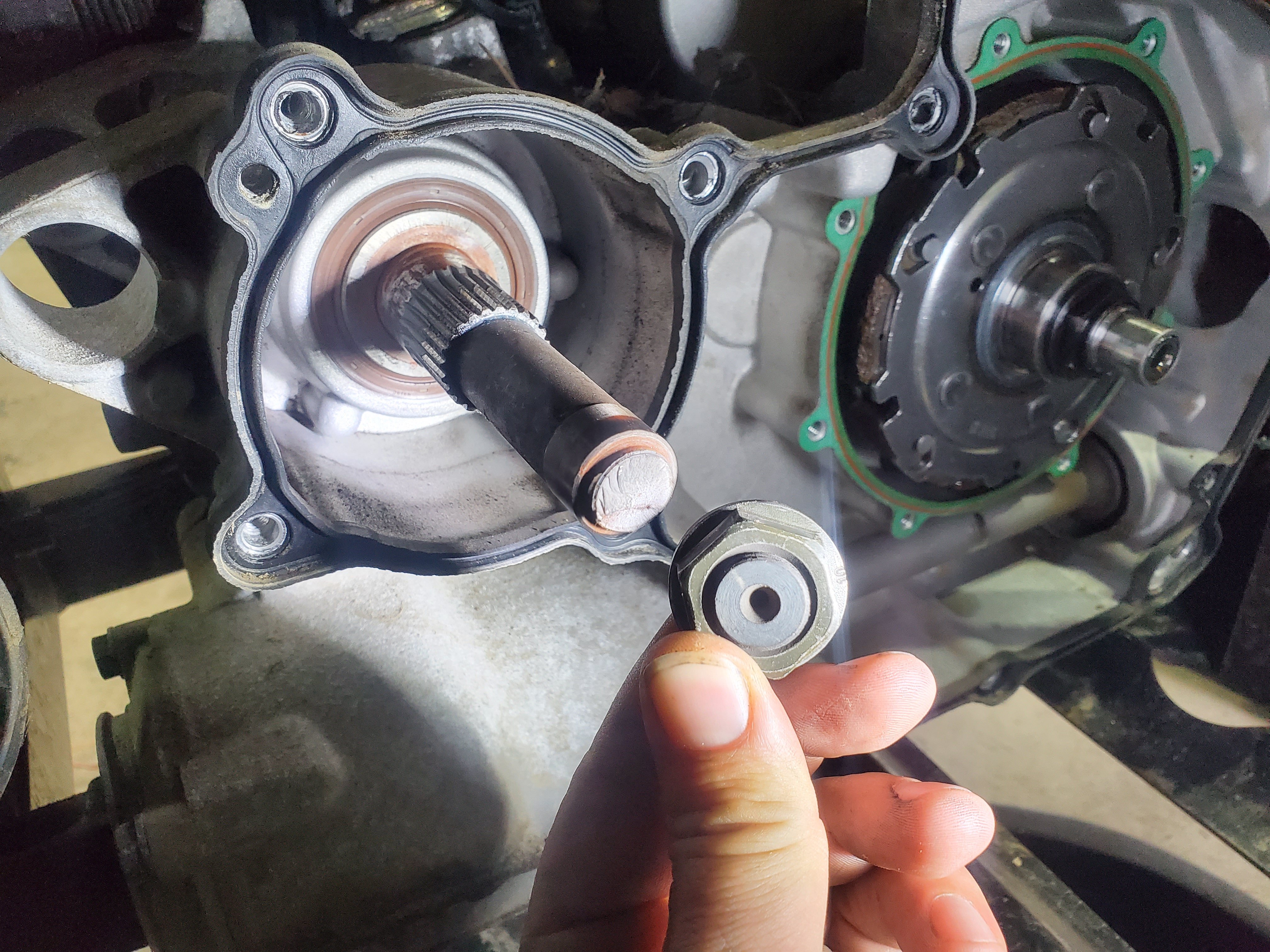

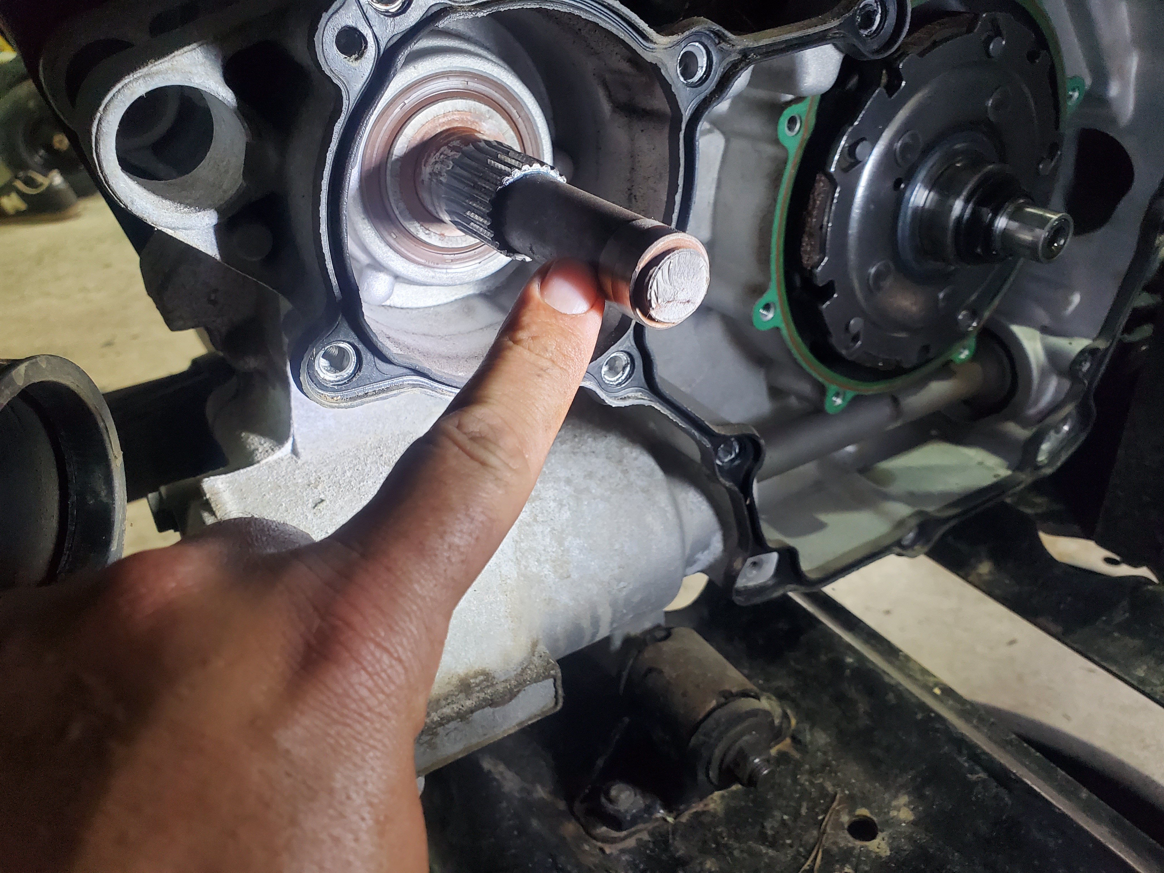

I am replacing my clutch and the nut on the main shaft snapped off on the secondary.  Does anyone know how to replace that shaft.  I can't find any info.  Thanks

Depending how far you want to go as far as repairs, I would consider drilling out the center of the shaft and the threaded part and taping them together with a strong bolt and then welding the two pieces together and then shaping them by hand so that the other part of the clutch fits correctly.  Take your time it can be done.
