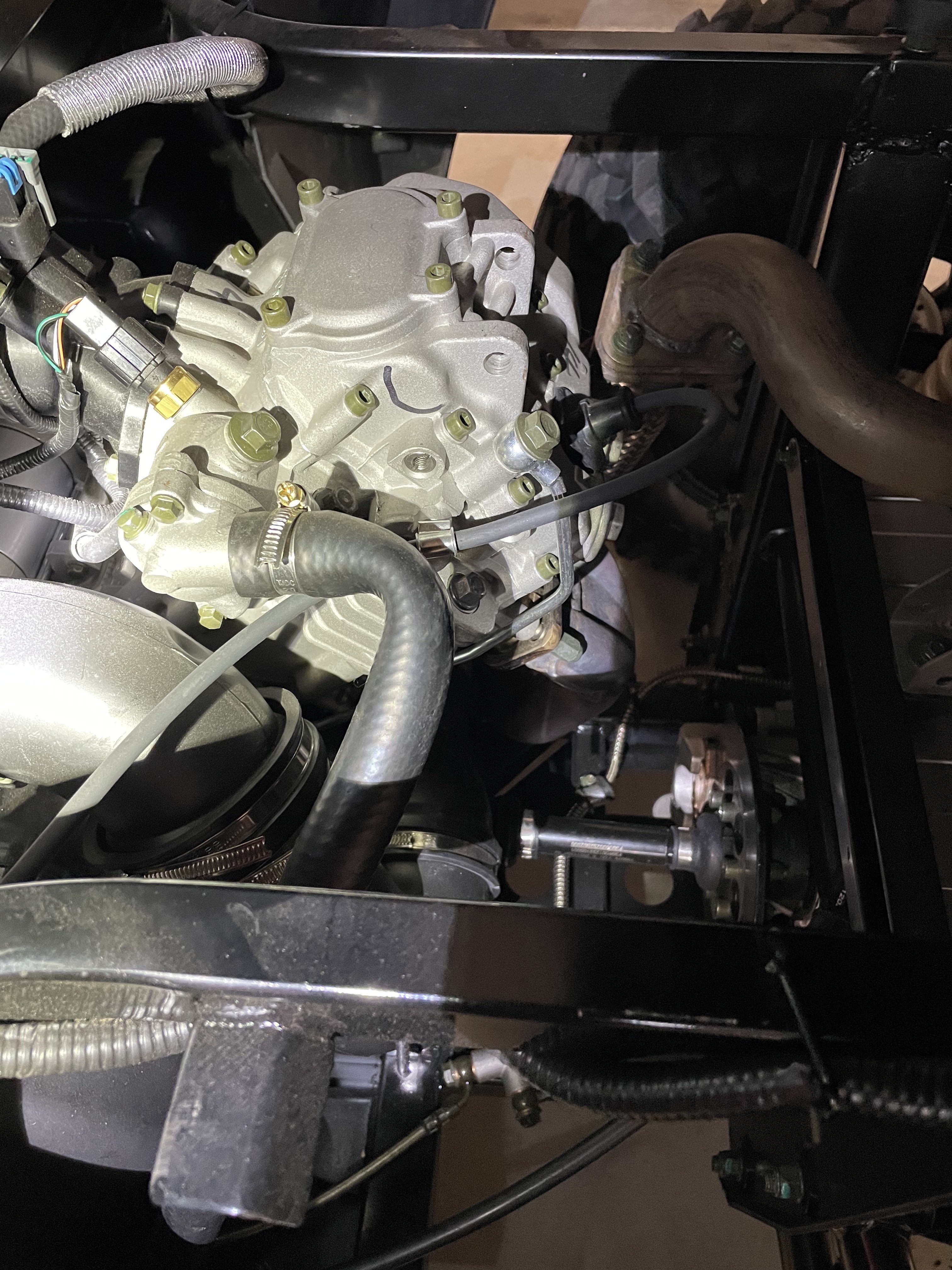

Coolant upper hose kinked (check yours)
By lincolnsq175
I have a 2020 coleman ut400.
Any info is appreciated.
