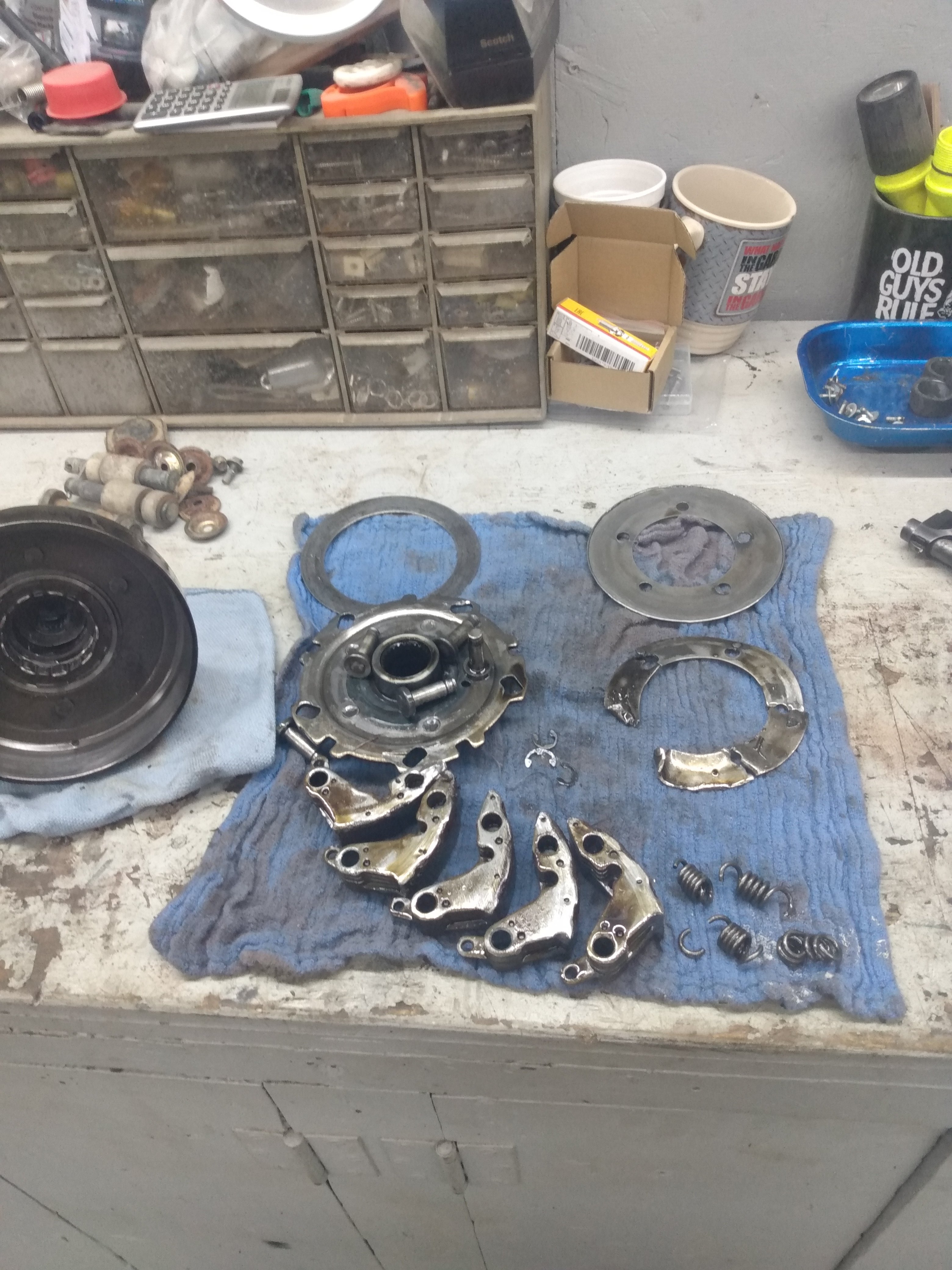

      3. Had a bad clutch - Replacing the entirety of the clutch system wasn't all that bad except its a tight space to work in to do this repair. was a pain to figure out the angle that I needed to get the cover off and then back on again but figured it out the second day and got it done.
