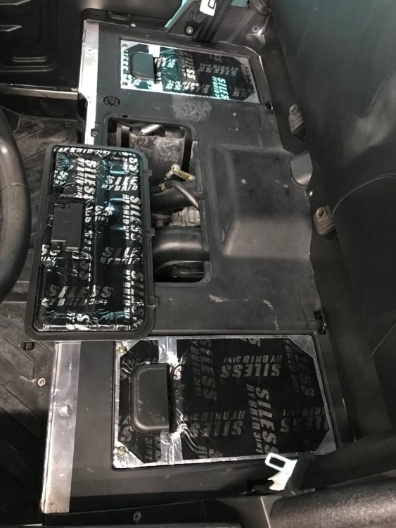

This will be a two- pronged attack for me. First is the silencer, because it’s too loud on the street (UTVs are street legal here, but this thing gets plenty of unwanted looks for noise). Second will be to add some sound deadening mat from behind seat all the way to the bottom of the dash in order to get at the “WHAT I CAN’T HEAR YOU” problem…
I’ll post my results with both.

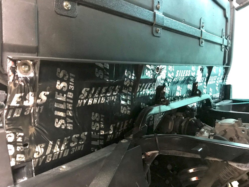

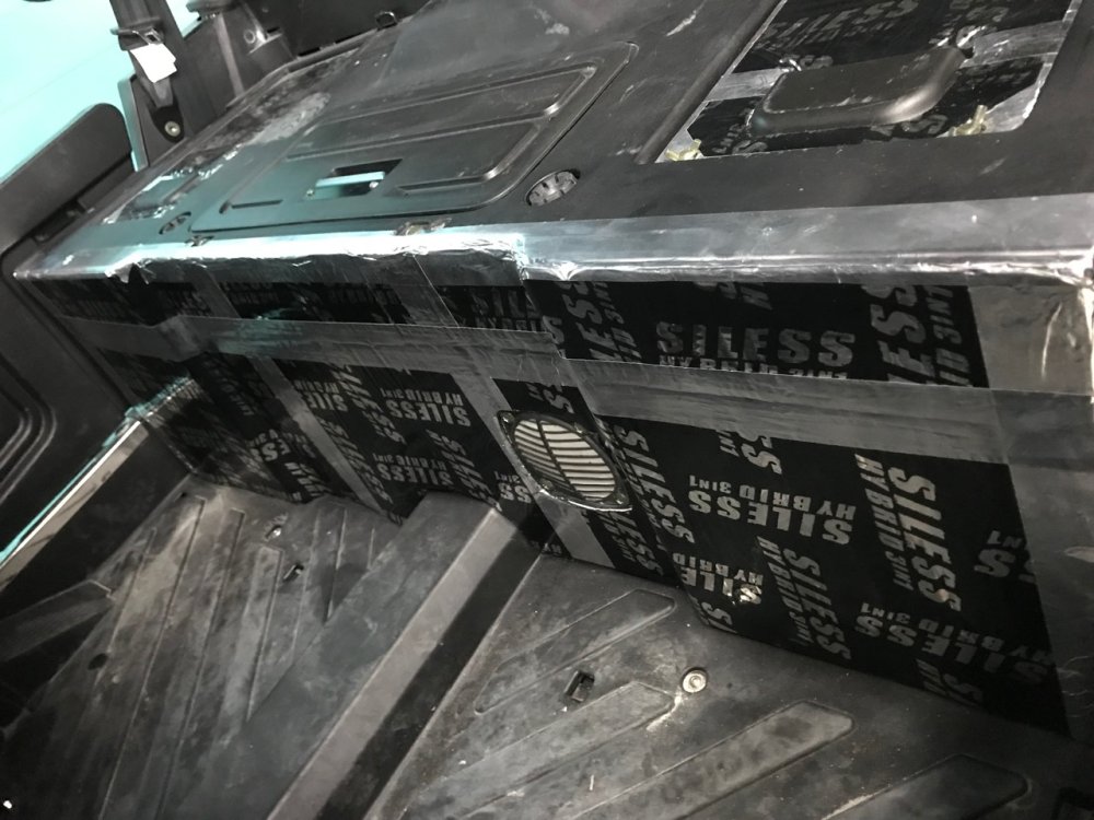

I just figured I'd get under the metal bed which seemed to resonate the engine/exhaust noise the most.
I guess I could also do the inside of the plastic behind your feet. I also avoided under the wheel wells because on the Coleman 400 there are no rear fender liners and I was concerned that it would be an issue with mud getting kicked up.

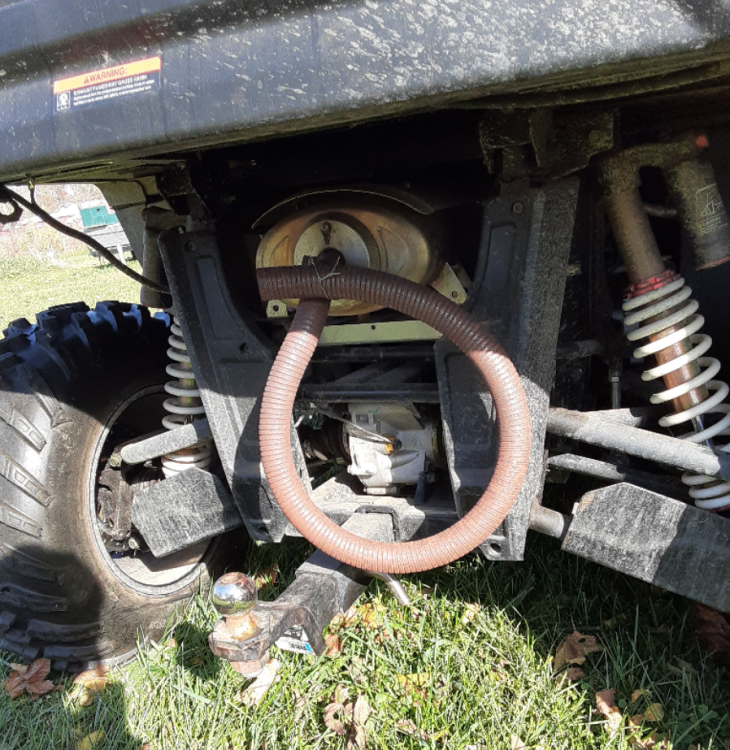

I have a 2021 outfitter 550 and the first thing I did for the noise was hang a coil of about 3 feet of 1.125 inch flex exhaust hose on the end of the muffler. I've been running it for a year with no problems and no perceived loss of power. I had to play around with some copper plumbing fittings to make the connection. After reading about aefron88's use of sound deadening material, that may be my next effort.
