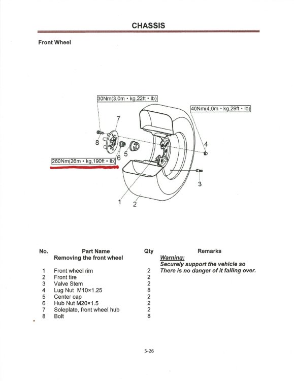

I had Front left brake squeak. Removed wheel to investigate and found hub nut loose. Torqued to specs as close as I could, and that seems to have cured brake squeak problem.
Good stuff .....thank you!

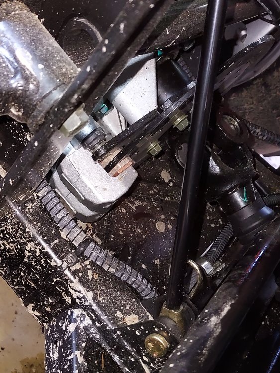

I was under the rig playing today so I decided to adjust the parking brake just to make sure it was ok, since I've read a couple people having them adjusted too tight from the factory.
First picture is the parking brake disc & caliper from the passenger side. Second picture is the adjustment bolt.
How it works: it's a cable operated disc brake with a locking pawl to hold it where you push the pedal to.
Procedure: The pad tightness is adjusted by moving the bolt in the 2nd picture in and out. When you tighten it it pushes the pads together. The extra nut on it is a lock nut.
Using a 13mm wrench loosen the lock nut. Back it off about halfway just so it's out of the way. Next tighten the bolt by hand until it stops. From there back it off about a half turn. Push the parking brake and make sure the pedal "locks up" before running out of travel. If it doesn't adjust the bolt slightly tighter and try it again. Once you're happy with the adjustment tighten the lock nut while keeping the bolt 20220715_153255.thumb.jpg.e66ac077bfb4436eaf94b0250a6c6d8d.jpgstationary.20220715_153305.thumb.jpg.bb8132472b5366a9581e82bb8e097ef3.jpg

Another little thing I did was lubricate the brake pin at the bottom of the brake assembly. It has a rubber boot covering it. I slid it back with a screw driver and squirted some white lithium grease in it and so far no more squeaking.

I didn't have a squealing issue on mine when I did this, it was essentially brand new and only had a couple miles on it.
It was definitely too tight from the factory, and it won't hurt to adjust. It's also quick and easy to do.
The parking park was fine with mine, but backed it off just a tad anyway. What solved the squeak  was  I was removed the wheels one at a time , turned the soleplate by hand and found that the front left ( drivers side) one squeaked . I loosened and re torqued the  hub nut and sprayed brake cleaner to clean any debris  and the squeal stopped and has not returned. Thanks everyone for their help and input! This pic from Robert B helped

I have a 2021 UTV400 and when I purchased it recently it made no noise. I get it home and a couple days later I hear the same squeaking as in the video posted by Rob, seemingly coming from the back. Now I hear it all over, as it's getting worse. Looking at all the rotors, brakes and parking brakes, they look like they're grooved, but when feeling them, they are smooth with little to no feeling of any indentation.
At first I thought it was the parking brakes, but when released, I can easily push the UTV, although the e-brake pedal is high with little travel when applied.
Good stuff here, as I will have to check all the brakes and adjust the e-brake. Hopefully I can pinpoint the problem, as I mentioned, it's getting worse.

Good info, but I'm not sure which bolts in the second picture you are referring to. I think I need to adjust my e-brake because the pedal doesn't travel much at all when applied and I have squeaks that sound like they're from brakes and coming from all over. Need to check them all, but want to start with this. If you can clarify which one of the bolts is the adjuster, I would appreciate it - thank you.

I had jacked my rear up and tried spinning my wheels and there was a bit of resistance, as well as the wheels not spinning as they would on a car. Took the wheels off and tried spinning the soleplates and it was really hard to turn. It this normal or could the hub nuts be too tight? On vehicles I've worked on, wheels spin easily, but I know this is a different animal, something I've never worked on. So with that said, should the wheels/soleplates spin freely with many turns?
This is all to to me as well, I can't say I know the answer to that, wish I did though. When I turned the soleplate I noticed the squeak. I did like I said and noticed the squeak went away.  At that point I was happy and unfortunately I didn't really pay attention to how freely it spun. I am going to need to do some maintenance here soon as I'm starting to hear the squeak again, its not as bad , but its there. It could be just in need of some cleaning.
