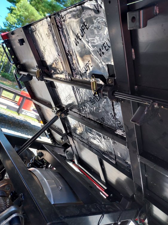

Playing on some crappy gravel roads I've noticed a fair bit of rattling from the bed area.
I decided to try adding some soundproofing mat under the bed.
Here's what I did: I got some peel and stick sound matting with a foil backing off Amazon. It's meant for sound deadening in automotive applications.
I Cut the pieces to size so they would fit between the framing and applied. I only did the middle as the sides of the bed are part of the wheelwell and subject to mud spray and splashing.
It has eliminated all the bed rattle and seems to have reduced some of the engine noise.
I've done a few test drives and have no heat issues on the matting.
