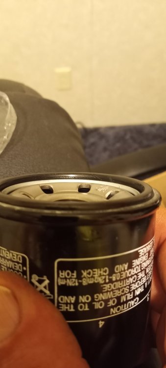

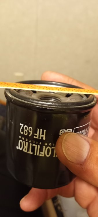

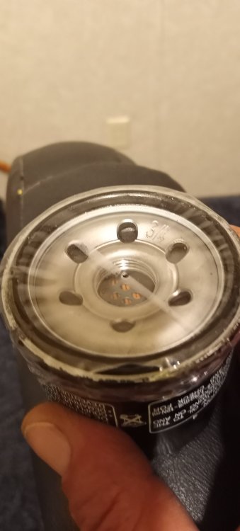

Since Massimo is made by Hisun, just like my Axis. I was able to use a hiflofiltro hf682 oil filter from Amazon. I bought a 4 pack for my cfmoto. Tried it on my 2022 Axis 500 and it worked perfectly. From my understanding all Hisun engines uses the same oil filter. OR if you have to have one ASAP. You could go to Lowes and pick up one for a Axis. At least my Lowes carries the oil filters for the Axis now since they started selling them.
From what I've seen from posts on this site about someone wanting to know what filter to use. When I did a search on this site.
The hiflofiltor hf682 filter is concave further with the center hole you use to screw the oil filter on with is a further IN the filter than standard filters are.
If this filter will work for his massimo I don't know. I know it works great for the axis 500. And since hisum makes I'm assuming it will.
The gasket or o-ring is rounded. But I think the key is the concave. Maybe both concave and rounded gasket.

you said it brother..    as for filter, the Amazon filter worked on my MSU 500
